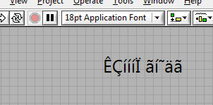

I have installed two different versions of LabVIEW on my Laptop, LV 2009 - 32 bit and LV 2010 - 32 bit (as evalution - for testing) and the OS is Win7 - 64 bit
I have a problem with LV2010. In LV2010 when I choose secound keyboard language by pressing left Alt+Shift (Arabic) and type in string boxes such String Controls, Labels, Captions, VI's Run-Time name (Windows title) and so on, LabVIEW has show all characters illegaly. Specially when using Application Font or System Font or Dialog Font. While Windows titles, Case Structure's name and so on using these fonts as default. Take a look at pictures. There is not such problem in LV2009. It seems that is because of installing two versions on a computer. Is there any way to fix it?
Message 8 of 10
(4,559 Views)
Any suggestions ??
