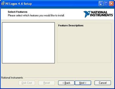

I had some problem to setup my PC to run an application as a VI Server. I always had the error #1379 "LabVIEW:  The user failed a security authentication check." when my client vi tries to connect to the Vi Server.
We contact NI to have some inputs and the answer was:
...Another thing we can try is to put the device driver you are using on the
server computer. According to this discussion forum, this resolved the
error for some other customers of ours.
Error 1379 in Open Application Reference
http://forums.ni.com/t5/LabVIEW/Error-1379-occurred-at-Open-Application-Reference/td-p/356144/page/2...
So I try to install logos.mis that I found on the first CD of NI Device Drivers (D:\products\shared\logos\logos100). The problem: the logos installer starts but I obtain an empty window when they ask to select features to install (see picture attached) ???
22695i8C44FA0AEFD9F328
The followup by NI was to tell us to install NI-DAQmx 8.1. So, I install all default compoments suggested by the NI-DAQmx 8.1 installer.
It works!
But we need to install the minimum drivers on the PC that will run the app Vi Server.
My question is:  Why the logos installer gave my an empty features window (if it suppose to solve my problem)? And, what is the compoment installed on the server by NI-DAQmx 8.1 that solve the problem?

My ViServer:MachineAccess was previously set with "*". My problem was resolve by the only fact to install NI-DAQmx 8.1 on the PC that's run the VIServer.
I saw in few posting that by only installing logos.msi (without any problem I supposed) solve the problem err #1379...
The thing is that I am not able to use the logos.msi : no features to install available (see picture at the beginning of the thread).
I want to install the minimum on my server PC, not all the NI-DAQmx 8.1 drivers.
NOTE that I solve the problem by installing default compoments suggested from NI-DAQmx 8.1 (it install over 75 compoments!).
How to know the only compoments (or mayby 2 or 3) needed to make the Vi Server running?

I looked a bit more at this, and the list doesn't populate on any version of Logos as it's not intended as an installer that requires user configuration. If you continue through the installer, though, the component should install anyway. Give that a shot and post back with your results?

To verify this, I removed all NI-Drivers from the PC used as server and verify that I obtain the same err #1379 with my client VI when trying to connect.
After that, I install only the logos.msi and press Next butten even if there is nothing to select in the features window and it starts the installation.
Try to connect to my VI Server and it works!
