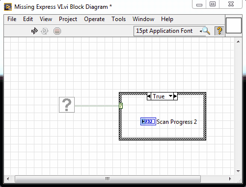

I don't have any code that easily reproduces this issue yet, but before I try to dig in and find some useful code I was wondering if anyone else has seen this issue.  LabVIEW 2015 SP1 32-bit Windows 7 x64.
I don't use too many express VIs but the Elapsed Time one is simple and pretty handy for stuff like not updating the UI all the time, or only running UI property nodes at a rate that the user can see.  But I've seen on several VIs, on multiple occasions where I will open the VI and it will be broken because a VI is missing.  I will then go to the missing VI and it is the Elasped Time Express VI.  So I will drop a new Elapsed Time Express VI and the missing one changes to be found.  I'll resave it and close it and it seems to be fine for a while.  But after some time the VI will be broken again.  I've resorted to saving a new copy of the express VI as a normal VI, and using that instead in some reuse functions that this keeps happening to.  If a VI has multiple Elapsed Time Express VIs in it all of them will be missing until I drop a new instance of that express VI and then they all get found.
So has anyone seen something like this?  Where an Express VI appears missing in a VI?

It's pretty difficult to reproduce so I'm unsure.  Attached is a VI that shows the Express VI as missing.  I took it from a larger VI and then started deleting stuff to make it a minimized example.  If you drop an Elapsed Timer express VI anywhere on the block diagram the missing VI is suddenly found.  Saved in 2015 SP1.

I see what you mean.  I'm opening it in LV2016.
Here are a couple things I see that may help explain it.
1.  While the express VI is still missing, I turned on context help and hovered over it to see if it gave a path.  It pointed to the path through the temp file director/Missing Express.vi/0    Seeing something called 0 was very strange.
2.  Once I placed a new express VI, the new one got called Elapsed Time2.  The missing one, was now found just like you said.  But I also noticed it did not have a name at all.  And there was no way I could click into the area where the name would be so I could give it a name.
So it seems like somehow it was saved with an empty name.
But then I played some more.  I found that the Express VI's you can hide and show the caption, and doing that (once it was present) popped up Elapsed Time2 and was now visible and editable.   There was no label option.   Going back to the original, broken VI.  I could right click and Show label, (there was no "caption" option).  I also unchecked show as icon.  And doing those things caused it to show a 0 as a name.  Then dropping a good Express VI caused it to show up as Elapsed Time2 has a name.
So there is some sort of weird mismatch with names and captions and labels going on here.  Saving the "fixed" VI, closing and reopening, it was still in the fixed state.

Okay some good information guys.  Yeah in 100% of the times I use this Express VI I will drop it down, turn it into an icon (right click view as icon), and then for some stupid reason the caption is turned on, so I then right click Visible Items >> and turn off Caption.  Not sure why anyone using this function wouldn't configure this this way but still.  Also not sure if the issue is somehow related to how I configure it.
Yes fixing this is relatively easy, and you can then save the VI and close and re-open and the issue is gone...for now.  After some amount of time and editing it will come back, and sometimes in VIs that I don't edit myself.  I've seen this issue in some of our reuse libraries.  Before building a VIPM package I run a Pre-Build VI that sets things like VI descriptions, locks the block diagram, and disables debugging and automatic error handling among a few other things.  So if I edit a VI in my package I will rebuild the package, which runs this scripting code on all VIs in the package.  Then I'll install the package only to see a VI from it is broken.  I open it and sure enough the Elapsed Time is missing.  I then open the source and the VI is broken there.  So I fix it, then build the package again, and install it and everything is fine...for now.  But as I mentioned before I also see this on VIs I edit which don't get edited by some scripting code.  Can anyone from NI look into this VI and why it thinks the express VI is missing?  I'm thinking of just not using this and replacing all the calls with my own normal VI.
