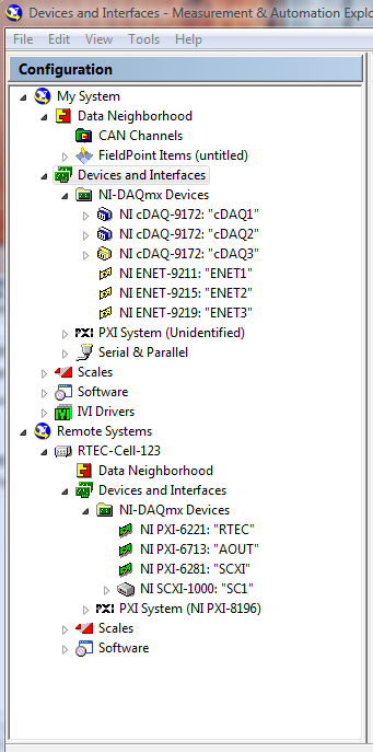

Well, that sounds promising, but it doesn't seem to work.
I do not have a "network devices" section in MAX.
When I run my little test program (which reads from "ENET1") on the host it's fine (I get a noisy sine wave, as expected).
But if I run it on PXI, I get Error -200220 : device identifier is invalid (ENET1).
MAX looks like this:

Howdy Steve!
I realized that you will indeed need to upgrade to DAQmx 9.0 to have the Network Devices section.  Below is a screenshot from MAX on my machine (using DAQmx 9.0.2; VISA 4.6; MAX 4.6.2).  The description on the right states the need for DAQmx 9.0.  I apologize for not realizing this earlier.

OK our messages crossed on the wires.  Is that MAX shot on a remote PXI system, or the host?  I can't tell from looking at it.
EDIT:  That has to be the host, as it has a PXI section below.
I hope that means that once configured, the device is visible from PXI.
Message Edited by CoastalMaineBird on 05-28-2010 02:05 PM

You are correct that the screenshot I posted was from a host machine.  Also, you are correct that it will not be possible to configure the remote PXI target to communicate with the simulated device.  I had originally thought that this could be done, but after further testing it turns out that I was wrong.  As you stated the address translation prevents this from being possible.
