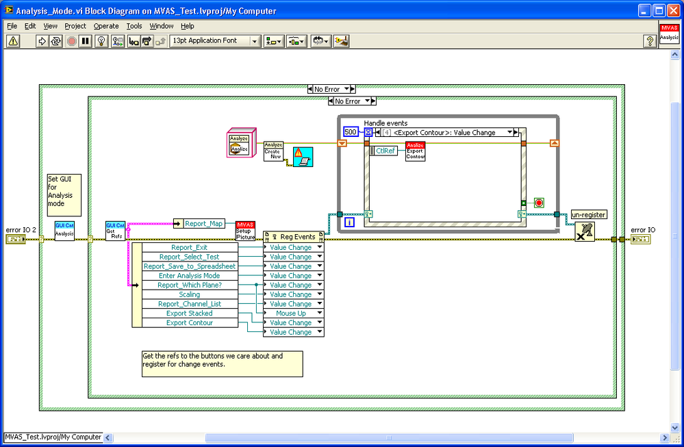

However, I gave it a shot and wired up a simple example:
There is only one dynamic event case that can be configured, but changing either boolean results in an event occurring and the 'CtrlRef' corresponds to the changed control. I guess another way to think about it would be that wiring an array of refnums will cause an event to be generated if any of the refnums undergo a Value Change. This is basically what crossrulz said above (thanks :)). What I was unsure about was what exactly 'CtlRef' would point to, or if you'd be able to determine which refnum the value change occurred in.

Your logic looks good. This basic technique can be very helpful when you have a number of buttons that do similar things. You can have one event that handles all the value change events and then use the label to see what button was clicked.
The control reference you get from the event data can be used in any way you would a reference from the control itself. For example is a button toggles between two states, you can use this reference to change the button's boolean text to reflect its state change.
