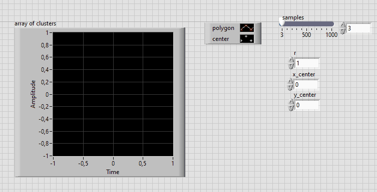

@deceased wrote:
True, just need to be careful with the requirement for n+1 ramp points for n unique points.
let's use the xy graph's linear interpolation to transform this into a regular polygon generator
Spoiler
Message 12 of 13
(917 Views)
Slightly simpler...
Spoiler
I would also ensure that the graph area is square and that the x and y axes range is identical to avoid distortions.
Message 13 of 13
