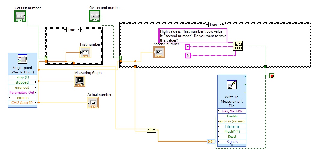

i am getting numbers to the numeric controls and i want to display this values in Two button dialog. (High value is: "my 1. number". Low value is: "my 2. number". Do you want to save this values? Y/N )
Please, do you have any ideas, how to write this variable values to dialog?

Hi peldao,
use FormatIntoString with your dialog text…
(3,377 Views)
Thank you so much for such a quick reply. This is what i needed.
