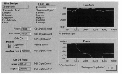

Hello everyone I am trying to design a IIR Filter but unable to complete it because of two Errors. I am using Labview Community edition. Here is a snippet of it. The errors are "You have connected terminals of different types". Do I have to change properties of Sink or source? The other problem I am facing is I am unable to create a cluster of waveform graph to show magnitude and phase respponse. The ones in the image are just clusters how do i do it? I have also attatched a VI file. It would be great help if anyone answered.

Thank you for trying but the desired output is:

The on block you disabled in the VI should not be disabled. Anyway thanks for trying again and again but I am just looking to connect multiply VI to bundle and unwarp phase VI to bundle and then after bundle to Waveform cluster.
Do you know a way for that.?

The second element of the bundle is initialised using a double value (sampling frequency/1024) then you're trying to write an array of doubles to it from Unwrap Phase.vi.  For the third element, you're trying to write an array of doubles to a cluster.
