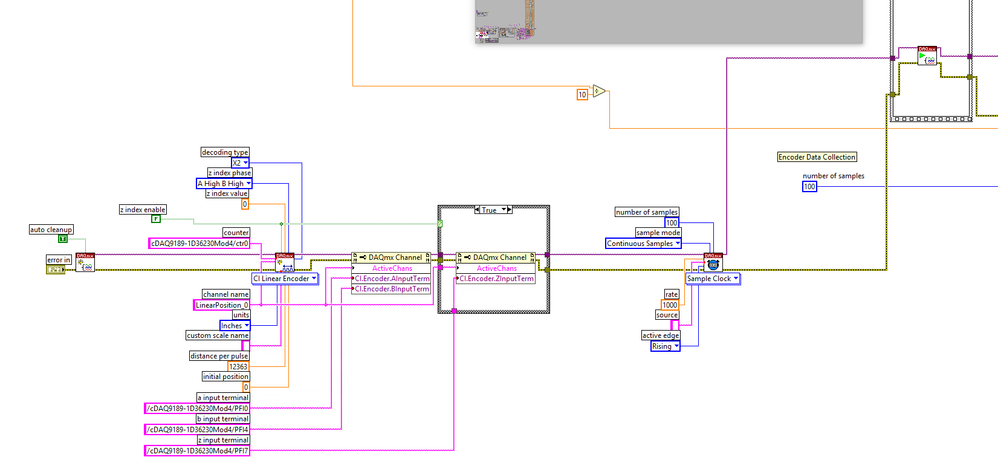

Difficulty Zeroing Quadrature Distance Encoder without Z Input
I found a similar post on this, the user found the only way to do so was to start and stop the task.
I've tried:
- adding stop task at end
- putting case structure around start task
- putting case structure on start and stop tasks
In all situations it just keeps incrementing. I wish there was a property on the channel that allowed for reset but I cannot find one for distance count, just edge count.
Any ideas? thank you.

I can only comment on what I see in the pictures.
You have set 'z index enable' = 'false'. I think this should be set to 'true'.
In your image there is a comment about scaling which should not be required.
I think the value for "distance per pulse" of 12363 inches is way too large.
Message 3 of 10

Attached is my code (Labview 2019 SP1)
In a previous iteration, I did do a zeroing by subtracting the count.... I am worried about the effectiveness this method, especially if running for large amounts of time, which is why I'm trying to figure out how to stop and restart the task. This seems doable in a contained loop, but I have it 'spread out' a bit in my program because I have a part that syncs up several acquisitions (the flat sequence structure).

Accepted by topic author downerdce
Here's the solution if anyone is interested. VI is attached in case you don't get it from this snippet.
Had to stop and restart the task with a button (or some other event) inside of my while loop. Thank you labview tech support.
