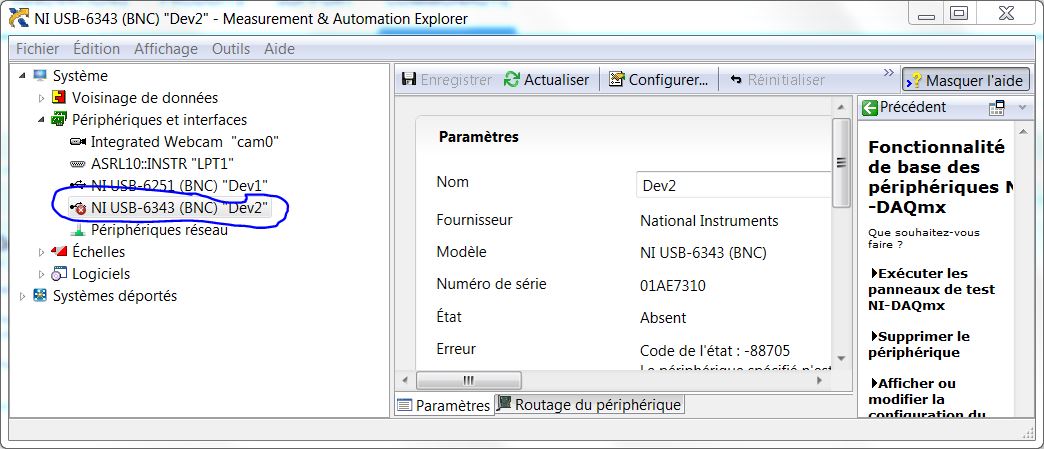

Hi GerdW,
Here is MAX window.
Device USB-6343 is actually disconected.
In my VI when I put Create Virtual Channel block, only USB-6251 is disponible.
But this last one doesn't have the same resources as USB-6343 (e.g. 2 analog outputs instead of 4).
What should I do in MAX in order to may use USB-6343 in my VI.
Thanks.

Hi Pavel,
delete the missing device and replace it by a simulated one.
Or create an additional simulated device…
Message 5 of 9
(3,927 Views)
Right-click on Devices and Interfaces and select "Create New...".  Choose a similated DAQmx device.  Search for the device you want to simulate and clock Ok.  You will now have a simulated version of the device that you can use to create virtual channels and tasks.

Thanks all,
Actually I'm on my home PC, where I've installed NI-DAQmx Runtime 15.5, that contains support USB-6343:
http://www.ni.com/download/ni-daqmx-run-time-engine-15.5/5903/en/
But after having reboot and run MAX I didn't find USB-6343 (actually no any USB device)

I am not completely sure it will work with just the DAQmx Runtime.  But after selecting the Simulated DAQmx Device, click on Finish and see what shows up in the insuing dialog.

Yes !
It's the case.
Thanks a lot.
