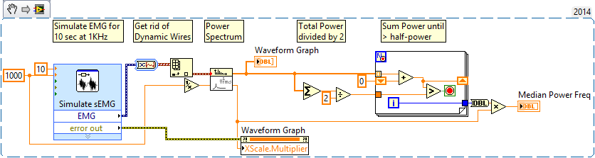

Another attempt but I was struggling to use the For loop you mentioned to get the median to work. Any comments on my mistakes?

Well, it's the Good News/Bad News Story.  As I posted previously, the Good News is that I solved your problem.  The Bad News is I didn't post the solution, hoping you would read what I wrote, follow my lead, and "do the right thing".  The further Bad News is that between then and now, the version I coded up got lost when I logged off my machine.
The Good News, however, is that I simply followed my previous post and recreated my earlier efforts.  Here it is:
The only thing I kept from your code was the Express VI (though I wired two of its inputs, Block Size = 10 seconds and Sampling Rate = 1000 Hz).  This generates the signal whose (ideal) spectrum can be seen by looking "inside" the Express VI.
Dynamic Wires "get in the way" of understanding what you are doing, so I get rid of them.  Indeed, the Express VI returns an array of Waveforms, so I "Index Array" to get the Waveform.  I take the Auto Power Spectrum, plot it (and get a plot consistent with the ideal spectrum, and compute the Half-Power (by summing the Spectrum to get total power and dividing by 2).  Now all I have to do is start "integrating" (a fancy word for "adding") the Spectrum until I exceed this half-power -- the frequency that puts me "over the top" is, by definition, the Median Power Frequency (OK, you can argue that it might be one frequency too big ...).
Notice the total absence of Express VIs and Dynamic Wires.  They are absolutely not needed, and (I would argue) "get in the way" of understanding the deeper meaning of the problem and its solution.
