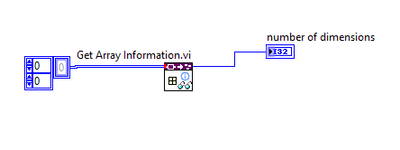

I'm not sure if this is available in LabVIEW 2014 as I don't have that version installed.
But at least in LabVIEW 2019 there is a VI called "Get Array Information.vi" in the variant vi's. It takes in an array of any dimension and returns a number of dimensions.
