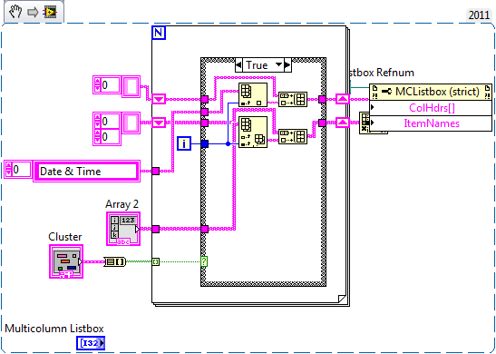

I hope someone can help me. I have come across a hurdle in the programming of my application.
I have an 2D array of 8x20 size. This data I have to show it in a multicolumn listbox. But I don't want to show all the data. From the front panel user will make the selection from the given options, which parameters he wants to display. I have attached the VI in which, from the cluster I sort the true indices and only keeping those parameters I have to delete all other columns. From the size of true indices am creating particular case for handling those parameter.
I have able to create only for size 1. Please find the posted VI and tell me any simple solution to this problem. I have tried searching various array function to sort out this problem.

Hope this helps as a starting point,

Hiii MacroMauri,
Its very simple and easy solution. Don't know why didn't I think in that way.
Thank u So much.
