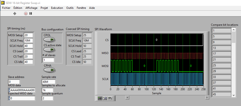

I am trying to delete a column of a waveform.
I created the waveform using the "SDW 16-bit Register Swap.vi" example from the "SPI Digital Waveform Reference Library" which I downloaded here: http://www.ni.com/example/31163/en/
This SPI waveform contains 4 signals:
  1. CS
  2. MISO -> I want to delete this one from the waveform
  3. MOSI
  4. SCLK
Front Panel of SDW 16-bit Register Swap.viFront Panel of SDW 16-bit Register Swap.viWaveform observed with probeWaveform observed with probe
I tried to extract the Y attribute from the waveform, which I thought would be Array, and then use "Delete From Array Function" to delete the column. (https://zone.ni.com/reference/en-XX/help/371361N-01/glang/delete_from_array/)
(This would be similar to what is done here to delete a portion of a waveform: https://forums.ni.com/t5/Example-Programs/Delete-Portion-Of-Waveform/ta-p/3510593)
However, I can't connect the Y attribute output to the Array functions!
Y attribute cannot be connected to "Delete From Array Function"Y attribute cannot be connected to "Delete From Array Function"
None of the Waveform Library function seems to do the trick either. Would anyone have any idea?

You can use the signal subset. Select the columns that you want to keep.
