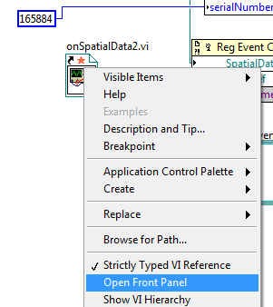

Like this?
 Then I go to its block diagram and put the probes on there:
Then I press run in the spatialtest4.vi and this shows!
Message 39 of 49
(2,204 Views)

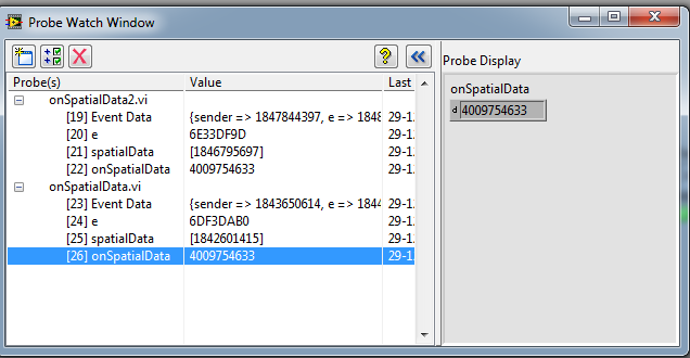

I did on both now, onspatialdata.vi and onspatialdata2.vi.
probe 22 and 26 have same value. Is this bad?
EDIT: It doesnt show errors 😞
