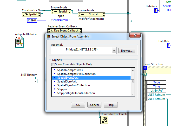

Hi again,
After wasting a lot of my time and some of your time also trying to solve the program and the delay, I did a test on the raw example provided by the Phidget website, I left the original program running for just 1 sensor for less than an hour, when i came back to it, the program had delay..... So I made everything starting already on a faulty program that had already that delay problem.... I was so mad but I have to solve this! So i searched for other options and i found an older version of the program no longer provided by the manufacturer, I tested it out and after 2 whole hours the delay was no there on this older version. So now I'm working on that one but i found another problem that I am not able to solve, I can't make it work for 2 sensors at the same time in paralel. The data from both sensors is sent together to both graphs.
I know this is my mistake I think, somehow the graphs are calling the data from both sensors when I want it to be separated, one graph showing for 1 sensor and the other one showing the data from the other sensor. Something about the net ref number or something like that. Again I suck in LabVIEW even after learning a lot by trying to do things by myself I cant solve this either. So I am here again asking for your help sadly, but hopefully someone will help me out
I cleaned up the block diagram, and upload the files in the attachments, the pictures and the VI's.
Please Help me:( I really need it!

Do I have to change the Spatial Data Event Callback? In the subVI called onSpatialData? I'm afraid of screwing up things more! But it seems the right place to change the RefNum!

First, Pardon me if i am telling something stupid.Because i don't know what Phidget is
Now coming to graphs and events.
-You are getting same data in two graphs because you are sending same data to both graphs.
-You are getting from same .NET Refnum, that is the problem ( this is my understanding)
-How about using two loops just same as your current one loop, each corresponds different sensor and then check if it works.
-In the project you added, i can see only onSpatialdata.vi only and where is onSpatialData2.vi? is it same?
-Please keep unregister for events in the right side after while loop is completed.
uday
Message 19 of 49
(2,888 Views)
Phidget is the name of the manufacturer of both sensors and they also name them phidget, the ones im currently using are the phidget spatial 1056 and an older version phidget spatial 1049.
-I know that is the problem, the data is being sent to the both graphs at the same time.
-Yes that is why this is happening, same .Net refnum but i dont know how to change or if that is even possible, i found this:spatialeventdata.png
But i think im forced to pick the spatialeventdata, so the refnum will be the same, I was thinking about renaming this or something but i dont know how, i even searched for Phidget21.NET in my computer but the files i found could not be renamed with my knowledge.
-I tried using 2 loops but te problem remains, then I tried to use a flat sequence structure on both while loops and I found something nice but it's not what I am looking for, with the flat sequece structure it starts to send the data of just 1 sensor into just 1 graph and when I stop that loop the other loop sends the correct data to the other graph, the problem is that I need them to work at the same time 😞
-Yes, the files are the same i simply copy pasted a new one and renamed it, i tried this because I tried a diferent way to do this but there was a delay, its a very long story, but the important part is that the other program had the same problem (data being merged together into 1 graph) and Phidget support told me that i should just rename the blocks and it would work, that it was an ugly way to do this but it should work, and it did.
http://forums.ni.com/t5/LabVIEW/2-phidgets-at-the-same-time-event-problem/td-p/2576289/page/2
-Ok, thank you I moved the unregister for events to the right side, it was there cuz that's where it was originally.
Thanks for the interest uday,
João Pereira.
