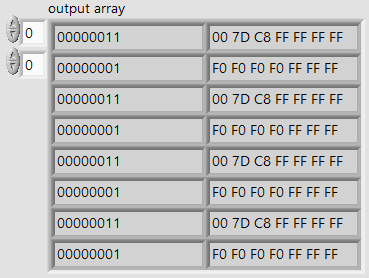

Hello All,
Currently i making Lin bus sniffer.
I solved communication, so this is no the issue.
Problem is representation of collected data.
I getting data frames, with same ID several time per second.
i need table that shows in one row one ID, and only value of data package has changing.
Like in example below... (IDs are fixed 85, 03, 3C , and the byts values are changed)
Also if new ID appear, new line should be created...
VI is in attachment.
Thank you.

Hi milan,
which LabVIEW version are you using? This sounds perfect for the LV2019 feature of maps/sets…
You need to create some kind of LUT (look-up table) and store only the latest message value per message ID. With older LabVIEW versions I sue variant attributes to store such LUTs, as has been described very long ago!

Here's a simple example showing the 2019 Map datatype used to do this:
It's worth noting that here, I haven't stored any time information, and the entries displayed in the map indicator are sorted according to however LabVIEW chooses to sort the key (you can't as far as I know control this).
If you wanted to store time values and sort by that, you could for example store a cluster of (time, value) in your map of (key, cluster). You'd need a specific way to display them then (perhaps in a 2D string array, or a Multicolumn Listbox, or similar). You could probably write a subVI to do this fairly easily.
Edit, for clarity, most of this example is not necessary if you have a real datasource. I put the top loop and queue in only so I could both "send" and "receive" data. The bottom loop is the one doing the collection, Map manipulation, and display.
