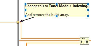

Hi liconj,
I made a little change on your VI.
Hope it works properly now.
