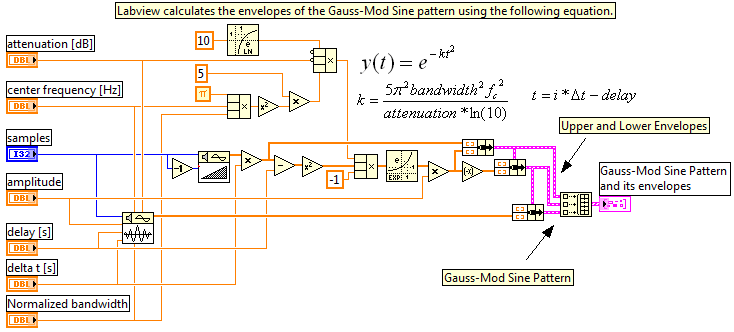

We all know that it's considered good style to comment our diagrams to enhance their readability and maintainability.  But have you ever considered using images to help comment your diagrams?  You can place images on your VI panels and diagrams when a picture will more easily convey information than a text comment.  For example, here's the diagram from a math example that ships with LabVIEW:
The image helps us better understand the mathematical formula at work in this LabVIEW code.  In another example, we have an image of a state diagram that helps us understand the different transitions in a standard LabVIEW state machine:
