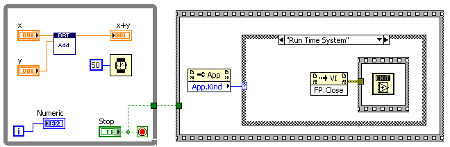

I guess the broader question here is:  Does code continue to run when you invoke FP.Close on the Main VI?  This nugget assumes "yes", but in practice it looks more like "for a really short time" (since code after the FP.Close sometimes executes and sometimes doesn't).  I attached the example project, VIs, and EXEs with my last post.
I think the correct answer is "until everything has been cleaned up".  The Close.FP suggested in the nugget is intended to give the user a clean window close without flicker.  The Exit LabVIEW is intended to get rid of the EXE app instance in case you've opened a bunch of references to stuff and haven't cleaned them up.
The "Close FP and Quit LV" EXE (diagram above) closes the subVI panel intermittently.  So, the Quit LabVIEW primitive at the end of that diagram seems to run sometimes and not others.  Practically speaking, it doesn't look like you can count on any code running after the FP.Close method.  Correct?  If you think your original post (similar to the "Close FP and Quit LV" EXE) is still appropriate, could you elaborate on your comment?  Thanks Darren.
When I have an app that spawns the panels of other VIs, I always open those panels programmatically...I never use the "Show Front Panel When Called" option, as you did with your example.  So in your case, I believe you'll need to take another approach, like the "Hide FP" approach that was described earlier.  But for those apps where child VIs are launched (and closed) programatically, I believe my suggestion is still appropriate.
To clarify, I was using "Show front panel when loaded" (not "when called") to demonstrate the problem with calling "Quit LabVIEW" after an FP.Close method.  But, to check your hypothesis, I added another EXE permutation to show the subVI front panel programmatically at the beginning and then exit by FP.Close and "Quit LabVIEW".  As seen previously, the "Quit LabVIEW" primitive runs intermittently (sometimes and not others).  This can be demonstrated by running the "Test Close FP and Quit LV - Launch Add SubVI" EXE and clicking the Stop button.  Sometimes "Quit LabVIEW" runs and closes both panels.  Other times it doesn't run, and the subVI panel remains open.
If you still stand behind your original post, maybe you could attach an example?  Otherwise, it looks like FP.Close is sufficient without the "Quit LabVIEW" OR a developer should use FP.Open (Hide) with the "Quit LabVIEW".
