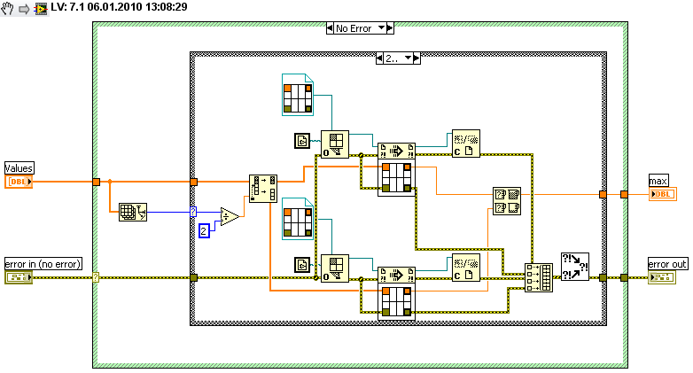

This is a recursive max finder that performs O(sqrt(n)) (I'm not really sure), the old way of VI Server recursion. It is terrible slow in LV 7.1., there are performance improvements in one of the 8.x versions. Maybe somone can recode it in 2009 with native recursion (and post a snippet) and do some benchmarks (I do not have 2009, but really enjoyed the ease of recursion when using an eval-version).
to make the snippet working, you need to set reentrant execution.
Felix

If you can show me what's in the other cases then I'll whip up an example without recursion....
Shane.

Simple:
Case ..0 returns -Inf
Case 1 returns (Index Array)
Case Error returns NaN
Felix
