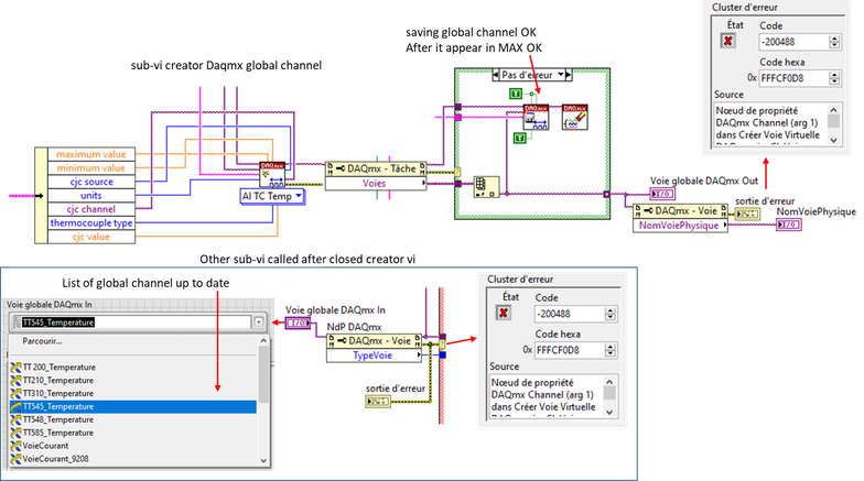

With Labview 2018 SP1,
When I dynamically create a global channel and we want to use a global channel property the error -200488 appears
The global channel is well created and existing in MAX.
it also exists in the channel list of the daqmx global channel command or indicator
but on using the property functions the channel is not found and the error occurs.
I haven't found a function to force any update of a cache or other after creation.
After restarting the VI the problem disappears and global channel properties are OK!
Does anyone have an idea of the problem?
