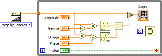

Thanks a lot, but I still dont know how to correctly create a graph for this.
I attached what i created.
Message 5 of 8
(4,299 Views)
Please do not maximize the front panel and diagram to the screen! This makes it difficult, because you cannot see both and you cannot see the help windows (which you need!) at the same time.
To create a time ramp, use ramp pattern, not a simple array control. Define start and end times and the number of desired points. There is also a function to negate. No need for anything blue.
Message 6 of 8
(4,282 Views)
Thank you,
I think it works. Do you think that's right?

Accepted by Feedy
Congratulations! I am sure you learned a lot.
Yes, it works, but there are a few flaws that have nothing to do with the algorithm, but are good habits to learn.
  • "Ramp by samples" never changes and can go before the loop since the output is always the same.. It only needs to run once when the VI starts, and not millions of times per second. Of course you could make its inputs controls (start,end time, # of points) and then it would need to go inside the loop, of course.,
  • As I already said, you loop needs a small wait (e.g. 50ms). Currently, it uses 100% of a CPU core mostly repeating the exactly same calculation over and over as fast as the computer allows. This wastes battery and makes your computer running hotter than needed. The loop does not need to spin faster than your capability of changing controls. (In the next lesson, you could even start using an event structure so the recalculation only happens when a control is changed).
  • There is still a function to negate. No need to multiply by -1.
  • Once all your controls have reasonable values, make their values default so we can immediately run it with typical data. At the moment all your controls are zero, giving a very uninteresting output. (enter reasonable values, select all controls (not indicators!), then menu...edit...make selected values default.)
  • You might want to add some scaling to have reasonable units (e.g. phase in degrees instead of radians). I sometimes prefer unit-less, making the slider go from -1 to 1, calling it "phase/pi", and multiplying with pi on the diagram (not shown).
  • It is not a good idea to have extra periods in the file name ("Damped oscill..vi")
  • Arrange the code more logically and avoid all these wire bends. Avoid unecessary right-to-left wires.
  • Make the controls more usable, e.g. by replacing them with sliders.
here's ow it could look like.
