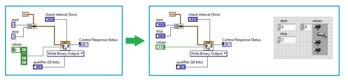

Hello Drew,
Some questions need to be confirmed with you.
1. Did you refer to the "Master Application.vi" when you created your Master VI? "Master Application.vi" indicates how to perform binary output too.
2. Did you try to build the master and outstation both on your PC? You can view the example VI, "Display Binary Ooutput Point.vi", as the outstation. In this way, you can find if there is something wrong on the Master VI.
3. Could you please send your Master VI to me for investigating?
Additional, according to your description, you should set the range from 0 to 3 and set values T/F. Please refer to the below screenshot.
Thanks!

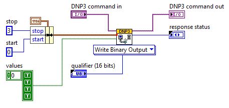

Hi Drew,
1. I have tested your Master VI and it can send out T/F normally.
For testing binary output, I disable some unnecessary VIs. And I shift the "start" and "stop" of the "range" to solve the error -44251. I use a example VI, "Display Binary Ooutput Point.vi", as the outstation. You can find it in <National Instruments>\LabVIEW xxxx\examples\DNP3\Get Started\Outstation.
In the Master VI, the "values" of the binary output is "F,T,F,F". In the outstation VI, you can see all 4 points by switching the "read point index" and the "Control" of "CROB value" indicates the status. They are "Latch Off,Latch on,Latch Off,Latch Off".
2. You can find 2 example VIs in <National Instruments>\LabVIEW xxxx\examples\DNP3\Get Started. The master is "Control Binary Output Point.vi" and the outstation is "Display Binary Output Point.vi". These 2 VIs use Control Relay Output Block(CROB) to perform binary output.
The "Send CROB.vi" sends one integrity binary command to outstation. You can send a intergrity command to outstation instead a binary output.
However, the "Send Write Binary Output.vi" which we are using in your Master VI, sends one binary output to outstation. So it can only changes the "Control" of "CROB value".
3. In order to using the "Send CROB.vi", you can refer to the master example VI, "Control Binary Output Point.vi".
Please see the below screenshot. You should set the "point index" from 0 to 3. In the "Control", "Latch On" represents "T" and "Latch Off" represents "F".
4. When we use the "Send Write Binary Output.vi" in Master VI to send binary output and use the example VI, "Display Binary Ooutput Point.vi", to be the outstation, we will get "IIN" response from the "Send Write Binary Output.vi". But, in my test, it will not impact the sending of T/F. Of course, if you use the "Send CROB.vi", the response will be "Success".
Thanks!

Hi Drew,
No problem. The data type of "CROB value" and "Control" are both cluster. So you need to bundle your logic (Latch On/Off) into the cluster. Please see the attachment. I create a brief sample and make the logic of switch1 as the example.
