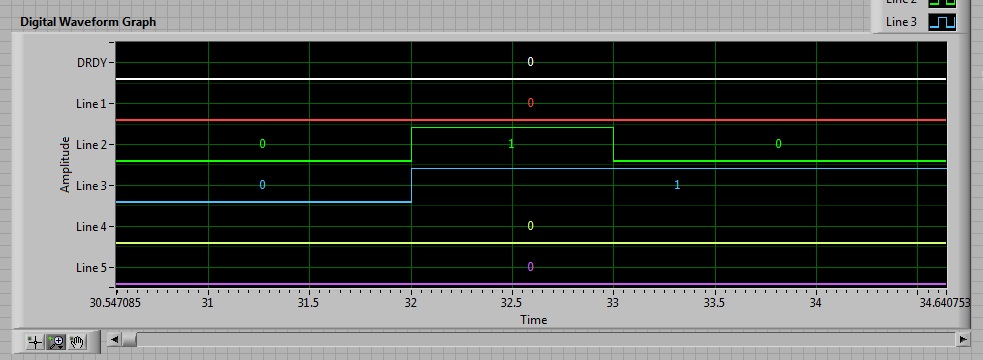

I am observing strange behavior of the DI input.
This is the situation:
Two signals are connected to the line DI2 and DI3 of the NI PCIe6537 with LV9.0f2.
When acquiring only these two channels the DI3 is half a clock cycle late after DI02, but they should be at the same time.
20573i431F1CA2A8055677
The strange thing is that when I just simply acquire channels DI0:5 I got different picture:
20571iBAC187A10125AA63
Can anybody explain to me why adding additional channels changes the relative timing between two DI2&DI3?
There is no change in the processing, just simply adding few more lines to acquire.
thanks

I think I found something, check this out.
The waveform control contains the data. IF I display all of them everything is OK,
20661i86A168B2542F6978
but if I delete the first two waveforms from the array the data is SHIFTED!!!
20663iCB4338CFE41FC6AF
I enclosed the VI for the ones who want to have fun. Run it and change the numeric calue from 0 to 2 to remove two first waveforms.

Hi pawel,
I wanted to upate you to let you know that when I run your VI I receive the same behavior, however, when I place a new graph from the Controls Palette»Graphs»Digital Waveform Graphs and use that it works as expected.  Try that out and I'll keep looking into what is going on.  Try this VI on your system to see what kind of behavior you see.
Dustin D
Message 9 of 10
(4,040 Views)
Hi Dustin
Thanks. After I realized that the graph itself was a problem I replaced it and it fixed the problem, so got the same behavior as yours.
thanks
Pawel
