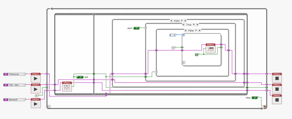

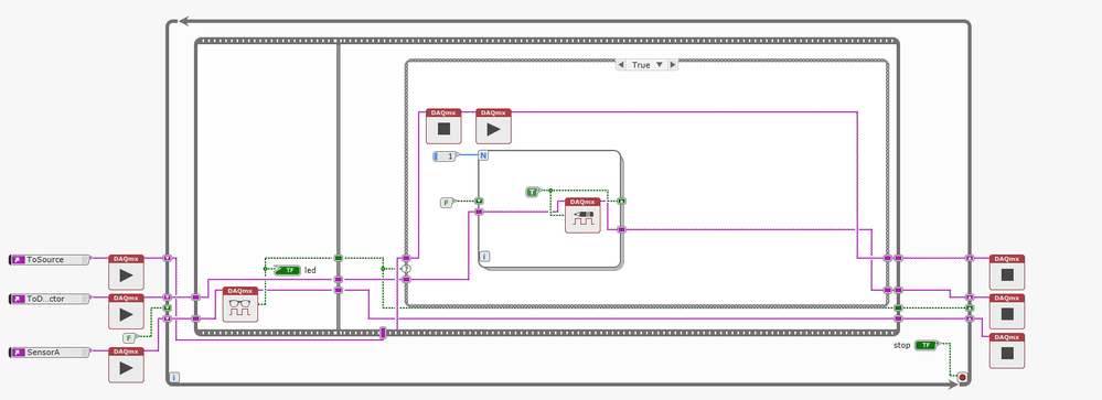

I am trying to make a program using DAQmx tasks. I have a one task that pushes a plate to a sensor and second task for pushing it back to start position (opening and closing valves). Sensor is a third task that lights up a LED in the panel when TRUE. When the sensor is TRUE, first task is supposed to be stopped and the plate needs to be pushed back. The issue I am having is that the first task is still active when LED is True and I end up blowing air (both valves open) in both directions. How can I make it stop when sensor is on? I appreciate your help!code.PNGcode2.PNGcode3.PNG

In order to tell what you are doing "wrong", I need to be able to see, clearly, what you are doing.  Providing a picture of your LabVIEW NXG code, which is difficult to see (because the images are so small), impossible to manipulate (because, unlike a VI, if I click on the image of a function and move the image, the attached wires stay put and become disconnected), impossible to see "what isn't shown" (like the other instances of a Case structure), impossible to execute (how do you "run" a picture?).
Please attach your VI.  Include sub-VIs if they are important to understand what you are trying to do.
I can see you have three independent loops, but can not see how they communicate with each other (maybe it's simply bad eyesight, or not having a big enough screen on my laptop).  I can see that each of your loops contains what seems to be an unnecessary (and therefore potentially "harmful") sequence structure (why didn't NI drop this structure, or banish it to the "Advanced" Palette where you need to show that you really do need it?).  Try eliminating all of the sequences, straightening your wires, making the three loops easier to read, and see if the answer leaps out at you.  For more help from the Community, attach your VI (I know I'm using the wrong name, "VI", for LabVIEW NXG code, but that's because I have about 10 times the experience with LabVIEW than I do with LabVIEW NXG -- so sue me ...).
