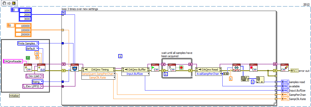

I was trying out some code on my developer pc. I don't have access at the moment to a real DAQmx card (DAQmx 9.5.5 installed), so I simulated in MAX 5.3.1f0 the PCIe-6353 card.
But I got in LV 2012 some unexpected behaviour and was wondering if that is by design or if it is a bug.
When I set for the Sample Clock a new value for the amount of samples, this number of samples is not read. Only when I set also a new value of sampling rate the correct number of samples is read.
I made some code to test this. For example I first set the number to 1000 samples, then 2000 and finally 3000. For the sampling rate I set it to 100,000; again 100,000 and finally a new value of 200,000. The amount of samples read is: 1000, 1000 and 3000. Thus when setting to 2000, this is not used somehow ...
Using different numbers has no effect.
Output
Attached is also the code

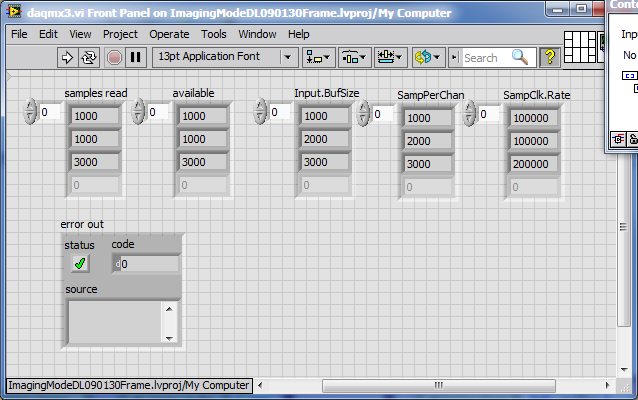

Regarding to your questions:
1. The amount of samples is given correctly: 1000, 2000, 3000
2. No, no warnings nor errors are produced
3. Sure, those are given correctly
Message 3 of 13
(3,753 Views)
Hm, looking at the screenshot, we learn two things:
a) The buffer is resized correctly (InputBufSize)
b) The amount of available data does not change properly (available)
That being said i am wondering if forcing DAQmx Read to fetch the #samples instead of "available" will create an error....
It seems to me that DAQmx erroneously does only resize the buffer but does not instruct the task to sample this amount of data.

OK, i just tested it with a simulated X-Series device using LV 2013 and DAQmx 9.7.5 and i can reproduce the issue.
Changing the #samples for DAQmx Timings is only modified for actual "reading" if the rate also alters (tested with .001 more which was already sufficient).
Another thing i tested is to explicitely include a "SampQuant.SampPerChan" property AFTER DAQmx Timing writing the same amount again. It also works, but i got the feeling that the loop is slowed down by that.
What i am wondering about:
DAQmx Timing.vi is only a single stacked property node. When a property fails to write, it will create an error. As this property node does NOT ignore errors, it should be passed on. All properties below the offending property will be skipped using this option (default option for property nodes).
So we can assume that SampQuant.SampPerChan is executed within DAQmx Timing.vi (buffer resize confirms this), but obviously the task is not updated correctly. I guess it is some timing race condition on the configuration of the task and proceeding to the next property in the stacked property node.
Please let me know if real hardware also encounter this issue.
