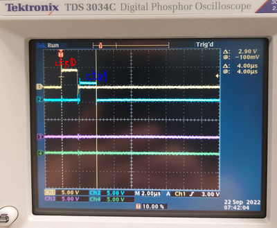

I count ticks of two two counters (ctr0/ctr1) on PXI-6602 to produce a pulse train like shown below. The trigger comes from PXI-6602 DIO every 500 mSec.
Everything is working fine, but when I change the "Samples per channel = 2", I get an error:
The idea is to double the pulses like shown below:
If I exclude (comment out) the 2nd counter (ctr1), I get the desired double pulse train, but I need the 2nd counter as well:
Attached is my LabVIEW 2012 VI.
Any idea what is wrong.

I'll try to be more specific.
This is acoustic sensor test in which I have to drive 4 channel transmitter with double pulse train. Each channel has 2 drive lines (+) and (-). I need 8 counters( 2 per tx channel = 8). The pulse train must be in specific time order. See the snippet.
In my original post, I attached a simplified version of my LabVIEW code with only 4 counters, here is attached the actual test VI that uses all 8 counters.
The trigger is a pulse that comes from PXI-6602 Digital output every 500 mSec.
This VI works with 1 Sample cycle. I am trying to use this old PXI-6602. I understand there are new time-based PXI products, but that will expense the project.
