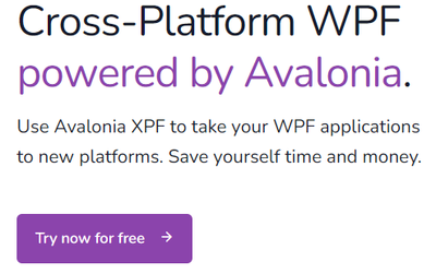

That doesn't reflect from the website at all. I stopped looking as it sure looks like a commercial product.
This didn't help:
Same here, was put off by the license costs of this one..... Almost makes LV look cheap in comparison. Pricing "Per App" or even "Per app, per year"
OTOH, even they include a "perpetual fallback" which enables the version of the year of purchase to still be functional even after a subscription expires. Just like the old Developer Suites.
