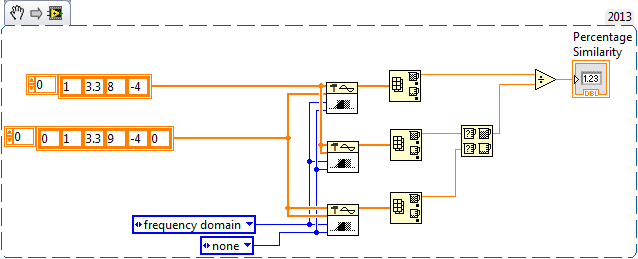

My solution doesn't have a mathematical basis for being correct, but I think it will give you something like what you want.
Given signal A and signal B
Max_Corr = Max( xcorr(A, B) )
Max_Corr_A = Max( xcorr(A, A) )
Max_Corr_B = Max( xcorr(B, B) )
Max_Corr_Possible = Max( Max_Corr_A, Max_Corr_B )
Percentage = Max_Corr / Max_Corr_Possible
Note: This is for xcorr with normalization set to 'none'

I don't know what's going wrong with your vi, perhaps the arrays are of different lengths? (check the error output of the dot product vi, always check errors, especially if you are getting erroneous results)
Anyways, cross correlation is NOT just a dot product. It is a dot product at every possible offset of the two signals (pretty much), which is why it has an array as an output (one output for each offset). (I guess it would be more appropriate to say that cross correlation is a function having a parameter of offset and returning the dot product with the signals offset. However most cross-correlation functions you are bound to come accross give the cross-correlation for each offset)
Here, take a look at the implementation of the suggestion I gave in my previous post.
