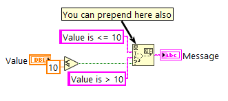

A case structure switches between alternative code paths and does not display any messages. Most likely you don't even need a case structure. Here's one possible code skeleton. Modify as needed.

@JÞB wrote:
Did you mean pick line? There is no need for that blue wire:D
It's an array, not a multiline string. Yes, pick line would work too but would also require a blue wire. Maybe you were thinking about append true/false string instead?
Sometimes it helps if the actual values are spelled out, so here's yet another way:

@JÞB wrote:
@altenbach wrote:
@ef99 wrote:
I am trying to create a case structure that will output a certain message when a value is input that is <=10 and a different message when a value is input that is >10. I know that the notation for the <=10 condition is '..10' but I can't figure out the notation for >10.
I agree with Ben that all you need is a simple comparison resulting in a boolean if the input is a floating point number. Of course of you are dealing with integers, all you need is two cases ( "..10" | "11..") and you are all set.
You can also use native string functions. (Pick line stills needs the blue wire)
