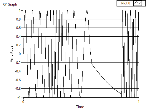

Suppose you know the angular velocity of your wheel (I'm going to call it "omega") at time t, know the current position of the wheel (I'm going to call it "theta"), and the sampling interval dt, and want to know the following three things:  the new position of the wheel (this is easy -- it is new-theta = theta + omega*dt), and the sine and cosine of this new angle.  This is most easily done using Complex Arithmetic and changing coordinate systems between Polar and Cartesian.  Oh, yes, omega and theta are in radians/sec and radians (so I don't have to mess with twopi).
Let's create a plot where Velocity starts at 0 rpm and increases by 1 rpm/sec and see what happens to the the position theta, sin(theta), and cos(theta) as we step in 0.1s steps from 0 to 30 seconds.
First, I want a function that takes theta (initially 0), omega (initially 0), and dt (0.1) and returns me an updated theta and its sine and cosine.  Then it is only a matter of keeping track of these values and waiting for 30 sec/dt = 300 time points.  Here's the Update function:
Update WheelUpdate Wheel
Note the use of Polar to Cartesian (in the Complex Numeric sub-Palette) to get me sines and cosines.  So now we just generate our positions (handling the conversion of 1 rpm into radians/second, which we only have to do once).  Actually, I'm going to show you only the Front Panel of the VI I made using Update Wheel.  This should be an easy exercise for you, and will demonstrate (as shown in the Front Panel) that you can easily generate a smoothly-changing Frequency sinusoid (it's "smooth" because I change frequently "smoothly" and slowly, only 1 rpm/sec = 0.1 rpm/tick).  You'd want to also "smoothly" change amplitude, again by every delta-t, changing it a little bit until you reach the value you want.
Demo Rotate WheelDemo Rotate Wheel
The Update Function above is a Snippet, but I'm also attaching it as a LabVIEW 2016 VI.
Message 6 of 12
(12,962 Views)
I assume you figured out how I made a "smoothly-changing frequency", namely by changing the rotation velocity of the Wheel with a ramp (or any other function without large "steps" -- it could have also been a sigmoid curve, for example).  So if you also want to change amplitude without introducing discontinuities, all you need to do is to multiply the Wheel position (which controls the timing of the waveform) by a similarly-smoothly-changing amplitude function.  If I still have the code I wrote for this example, it shouldn't take me more than 10 minutes to add "Amplitude" ...
Add Variable AmpAdd Variable Amp
It took 12 minutes.  I added an Amp input to the Update routine (it replaces the "constant amplitude" of 1 in that function) and just needed to incorporate the ramp change.  Something that should be obvious (I hope) is that the frequencies of the sinusoid "carrier frequency" needs to be significantly higher than the frequency (or reciprocal time interval) over which you make the changes to Carrier Frequency (FM) or Amplitude (AM).  Congratulations, you are simulating AM/FM transmission ...

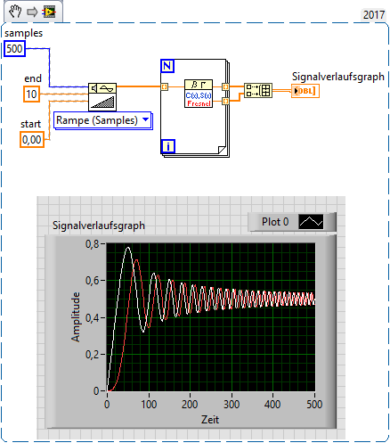

The graph above reminds me of https://zone.ni.com/reference/en-XX/help/371361R-01/gmath/fresnel_integrals/
