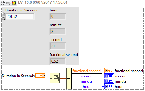

Although I didn't previously know that Seconds to Date/Time returned a cluster (so that's interesting) I don't think that you're right about your conclusion, unless I'm misunderstanding where you mean?
Using StDT will give me hours, minutes and seconds from 9am, 1904 or something and my input is a duration in seconds. So if I have 72 as the input, hours in the cluster is 9.
Or did you mean something else?

Double to time rec.pngSomething like this should work, no?

So now I'm pretty confident you're talking about the bottom part of the bottom snippet (with the Format to String node), but the problem is that the DBL value returned doesn't reflect a timestamp. As a result, the hours are wrong. You can see that in this example:

Ah, right! Set UTC input to true. 🙂
