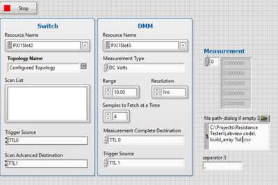

Hi thanks for confirming %d should work. I attach some screenshots here. Where should I put %d in the path? This VI is producing 4 values from DMM, say I want to create one csv file for each measurement. How do I do that?
As has been said before:
You use %d in a format into string, then build that into a file path.
I don't see any FormatIntoString function in your images:
Instead I see a whole bunch of Rube-Goldberg:
NEVER use ArrayToCluster followed by Unbundle when you can use a plain IndexArray function.
You don't need to call NumToFloat several times as it can handle an array as well!
That "separator" control should be a string constant…
Next time please post real code instead of images of code…
