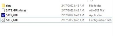

So this is what I did..( I cannot be on network).  Another colleague created an icon on a different machine for a different project.  My thought was I could just use that icon and modify it.  I copied it over to my machine in my project directory and modified it.   See scvts.ico.
This is where all my problems started. When I use it in my BUILD properties its still the same original scvts icon.  If I look in windows explorer I get different icons depending on which "VIEW" I use in windows explorer..see the next few files..
I spent too much time on this so I tried to go back to the default and it still keeps coming up w the original icon.  i deleted the build directory and its still there.  All I want to do now is use the default icons Labview ships with.  Any suggestions?  I don't even know where its finding the scvts .icon  I deleted it!!
As other suggested, Windows has now cached your exe icon. You will need to flush the windows icon cache. (google it)
To "fix" the icon, try opening it in the LV project icon editor, make a very minor change (single pixel) then save it.
EDIT: Oh, you will still need to clear your Windows cache after "fixing" your icon to see if it worked.
Hope this helps

None of that worked.  I deleted the project and recreated another one and that solved the problem.  To me that means the Icon is stored somewhere in my original project.  No idea why but problem solved.
Message 8 of 9
(4,885 Views)
No idea why...
As explained earlier, WINDOWS OS is trying to be "efficient" and stores your icon in a cache the first time you assign it one. By creating a new project, you created a new GUID that has no previous icon associated with it. Hence, it magically solved your icon problem. 🤔
