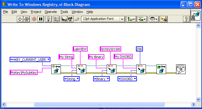

Could someone please check my code in the VI is correct before I try and run it. I'm not sure I understood the MSDN page correctly, and I'm just trying to create a function that does a RegCreateKey on a mobile Device in LabVIEW.
Function here:
http://msdn.microsoft.com/en-us/library/aa911940.aspx
VI attached. - Not complete because I didn't understand enough, but am I going in the right direction?

Examples for Reg entries can be found in the example finder.
Here is a screen shot for each of the vi's
Be careful in the registry. You also need to make sure that you have access to the registry to add and delete the entries. If you are planning to move this software to a customer be aware that they may not have full access to the registry if the IT group has locked them out of the registry.

OK... What exactly do you want checked? Your CLFN isn't set up with a DLL to call, or a function selected. Also, for Windows API functions you should be using the "stdcall (WINAPI)" calling convention. With respect to the function itself, the HKEY parameter is a handle, not a string. You also have most of the parameters not even wired to values.

Well, you did pretty good for being "just" a mechanical engineer, and not understanding DLLs. Smiley Wink
There's one thing that I still don't understand. aeastet had pointed out the examples that ship with LabVIEW. Did you take a look at them? The registry functions that ship with LabVIEW are just wrappers around calling the Windows API. In fact, if you open the Create Registry Key VI you can see it has a CLFN in there to call the RegCreateKeyExA function, which is what you're trying to do. It also shows you what values to wire up to the various parameters.

I believe smercurio to be right here.
Note, that I'm not doing LabVIEW for Mobile at all, but the Windows Mobile API is in large parts compatible with the standard Windows API, although the semantics of the underlaying system and implementation can vary sometimes quite a bit.
This means that as far as the calling setup of the Call Library Node for many Windows APIs you should not really have to modify the standard VI that is shipping with LabVIEW. If the function will behave in exactly the same way and with the same rights and restrictions is an entirely different story (usually they don't Smiley Mad ) but that has nothing to do with what you are trying to do here.
So why do you believe the standard registry VIs that come with LabVIEW won't work here? What sort of errors do you get when you try that?
