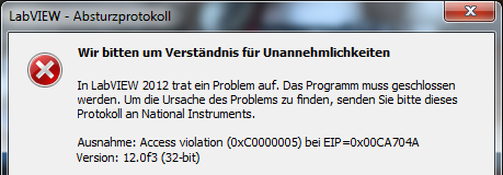

I can reproduce a crash in LV2013 32bit.
-run the vi ,
-rigth click the Z-scale and activate autoscale
-now replace the intensity graph with a waveform graph

Yes in my PC also it crashes. LabVIEW 2012 SP1.

thank you for bringing this to our attention. I could reproduce this issue also with LabVIEW 2014 and I created a bug report with the ID 507856. Have a nice day!
