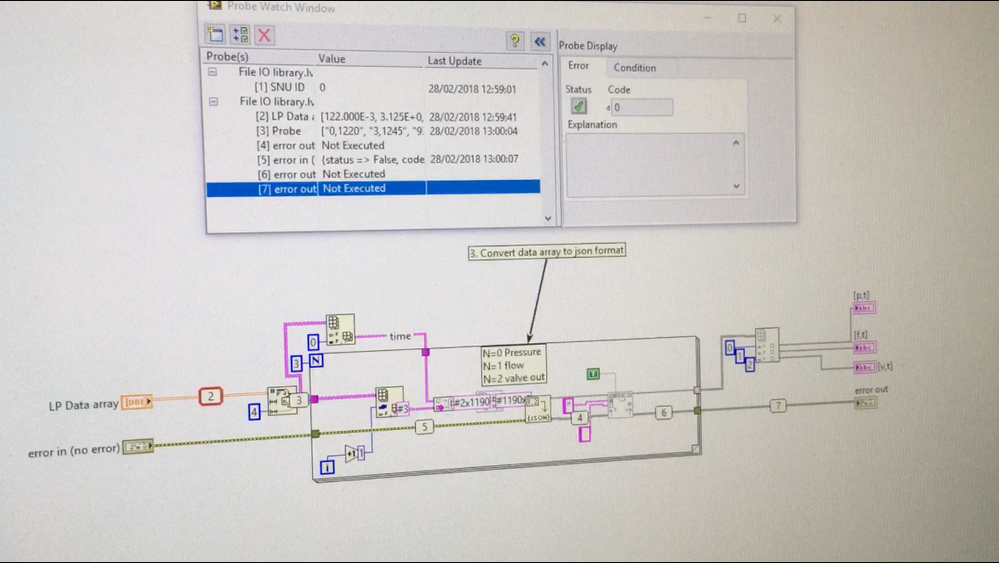

Hi everyone,
I am flattening a string array to json in LabVIEW 2013. As soon as it executes LV crashes with the report. Worked fine on my 2014 version, converted the version to 2013. My guess is that the transpose array has to do with it, since it runs fine without the transpose function. Any ideas anyone? Thanks.

Hello San_Punt,
to me this seems to be connected to this known issue of LabVIEW 2013: https://www.ni.com/en/support/documentation/bugs/13/archived--labview-2013-and-2013-sp1-known-issues.... It does not fit your code exactly, but maybe the workaround works for you as well.
LabVIEW will crash on run if array on connector pane is wired to Flatten to JSON primitive
N/A
Workaround: Remove array from connector pane, or wrap array in a cluster. Alternatively, add an Always Copy primitive before calling Flatten to JSON.
Reported Version: 2013    Resolved Version: 2014    Added: 08/19/2013

The always copy function did it for me . Many thanks!
