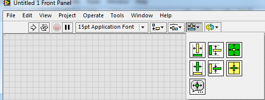

If you want to modify this for several controls at once, create them, select them and then use the "Resize Objects" button in the icon bar:
