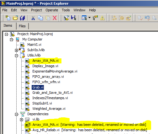

Thanks a lot for your help - I just followed your advise and created two libs and added them to my project. However, all the errors in dependencies are still there:
So, as you see, my Utils.lvlib has the VI called Array_WA_MA, but Dependecies still complains about it. If I were to add the file itself manually (not as part of the lvlib), then I would get a Resolve Conflict dialog and could tell LabView that now I want to load this VI from the new path, but here I don't see a way to do this.

Hi SensSLabs,
This doesn't appear to be a conflict-rather the VI hasn't been located on disk.  What is calling it? MainVI.VI?  If so, launch MainVI from the project and you should be prompted to locate the dependencies.

Thanks, Tom!
So, indeed, I had to tell LabView where to get all the dependedncies it could not find. Strangely, LabView had no problem locating some of them on its own, but needed me to point it to many others. I am not sure what was different about those that it did find on its own vs. those that it did not, but, OK, I'll take the result 🙂

Glad that worked- as for why LabVIEW was able to find some files- once you've pointed out a particular directory containing dependencies, the environment will assume that other dependencies may also be located there and will check before prompting you to locate a missing file.
