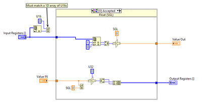

I am a little late to the party...
I am also working on modbus data conversion (my first time dealing with modbus) so I created a vim. I am relatively new to vims too so I am sure there could be some improvements 🙂
(8,310 Views)
