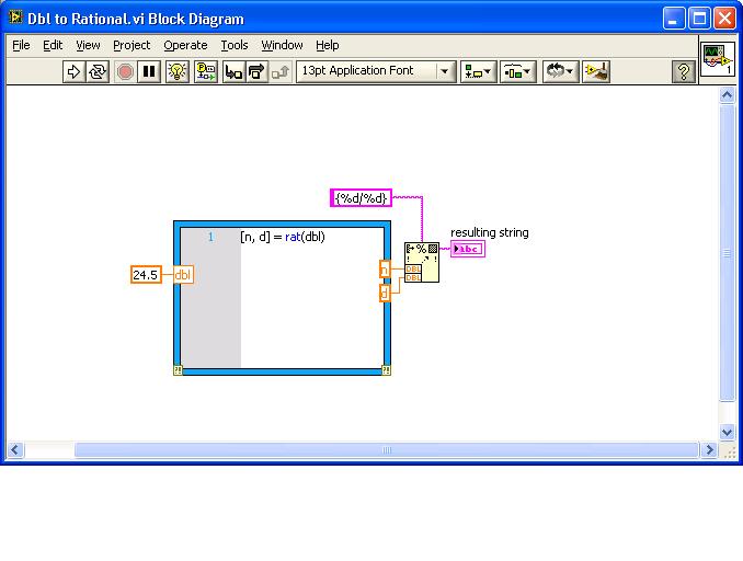

The TIFF tag header protocol requires a data type I am not really conversant with, the Rational Data type: http://en.wikipedia.org/wiki/Rational_data_type
I need to convert double precision numbers to this data type, e.g. 24.5 needs to be a ratio of two integers: {49,2}. Is there an existing LabVIEW algorithm to perform this operation? All my NI searches keep resulting in Rational ClearCase or Rational Array interpolation. I seem to have found a lot of the theory behind this: http://stackoverflow.com/questions/95727/how-to-convert-floats-to-human-readable-fractions
But, is this implemented in labVIEW already, or should I implement the above-referenced c-code?

That implementation is not in LabVIEW. Perhaps you may wish to post a suggestion to add it to a future release of LabVIEW.
If you have C code that will do it then you can call it using Call Library Function Node . You'll either need a DLL or you'll need to create one. Or, you can just convert the code to LabVIEW.

This should be possible if you have MathScript available.
 see attached ( LV 8.6.1)

Thanks Phillip!
A Matlab user such as myself should have thought of that method 🙂

I was curious if there were other ways to do this and found that Scilab combined with the LabVIEW Gateway works quite well. The 'rat' function is available in Scilab; Scilab and the LabVIEW gateway were both easy to install...
