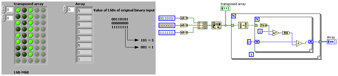

I'm not sure about the bit order, but I think this is what you want.  See attached VI, in LV2009, also included a picture.
- tbob

tbob,
Thanks for the quick reply. This isn't quite what I was looking for, but I think it can easily be modified to do what I want.
This is essentially taking the bits and them recombining them into a U8.  I actually just want a single bit array. So the output arrays will be U8, but will only have the value of 0 or 1.

I think TBob gave you what you were asking for, but just when a lot further with other math.
If you take his 3 U8 input values, the conversion to boolean arrays, the building of that into a 2-D array of booleans, then just index out the 0th and 7th column, you will then have two 1-D boolean arrays.  One for the msb, the other for the lsb.

Don't forget that we also have the 4.x version of typecast, which turns each U8 number into an 8 bit array containing the bits.
So, simply cast the U8 array to a boolean array in 4.x mode, reshape, and slice out the desired columns.
The attached demo should get you started. 😉
