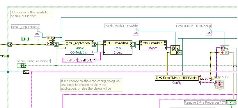

I've been trying to use TDMS to XLSX.vi to convert my TDMS file to Excel file. (http://forums.ni.com/t5/LabVIEW/Convert-Import-TDMS-to-Excel/td-p/1088746)
On my computer it works fine but when I try it on mu laptop and workstation I got property node error, code ise 97.(Property Node (arg 1) in Convert TMDS to XLSX80.vi)
I use Office 2007. Diadem 11.0 and Labview 2009 SP1

On second thought, that block diagram screenshot you posted is actually using the same Excel TDM Addin library I was suggesting.  I hear you saying you need this to happen programmatically, but we're in debugging mode now.  What happens if you load the TDMS file you were testing with into Excel with your mouse?  Does it work?  How large is that TDMS file?  How many channels and channel values are in it?

The Excel Add-In shipping with DIAdem 11.0 does not support the needed COM interface. Please download and install the newest version of the TDM Excel Add-In:

I did it. It didn't work 😕 And I'm sorry, I wrote it Diadem 11.0 but I've been using the version 11.1

Did you try Brads suggestion and load your TDMS file using Excel and the TDM Excel Add-In directly?
Just open Excel, go to the ribbon "Add-Ins" and use "Import a TDM(S) file". Does any error occur? If yes, can you please post the error message or provide a screenshot?

I clicked the TMDS importer but nothing happened..

Thanks a lot. Maybe the following article can help you:
http://zone.ni.com/devzone/cda/tut/p/id/5885
It looks like you have the "Non-Responsive Icons" issue.
