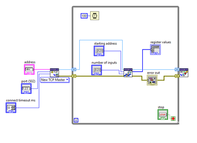

As of now, I'm trying to read a few register values to verify the connection between LabVIEW and the CT drive. Here's the front panel and block diagram. Is there anything wrong with my inputs?
I'm having trouble figuring out the corelation between Modbus Application Data Unit and the starting address and number of inputs.

Right click on that and do Explain Error.  I entered the number into Explain Error on the Help menu and got "Modbus Error: Illegal Function. This function is not implemented on the server."
So the controller doesn't seem to like the Modbus Read Holding registers command.  Possibly the modbus is not enabled on the controller.  Look in the Modbus communications section of the controller's manual.

The drive manual does say that the Unidrive M700 has a CT Modbus TCP/IP specification. Is there any setting I need to change to enable Modbus communication with LabVIEW?
