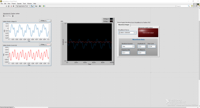

Hey there!😊
i am controlling my power supply via the Functino Generator of my VirtualBench. I can only set a Voltage in LabVIEW and i was asking myself, if it is possible to also set a current (A)? If yes, can somebody please help me out to make it work?
As always, every help is much appreciated❤️

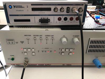

  1. As power supply i am using the "Toellner 7621". I´ll attach the manual!
2.
I hooked up a cable from the FGEN output at my virtual bench to the Input of my power supply.
3. Yes, i would like to control the current and the voltage to whatever is required!
Did I have to do more than just connect the 2 of them together and implement the waveform generator i downloaded?
Thank you very very much for your help!!!!

I'm not seeing any way to programmatically control that supply.  But there is a CV/CC button that you can press to switch between "Constant Voltage" and "Constant Current".

Can you please explain to me what you mean?
  1. Is it not possible to control the power supply in any form?
  2. Or is my specific goal that i had in this post not possible? That i have a constant current and voltage setup? And why?
  3. And also, IF it is not possible to control it in ANY way, how come that i can change the waveform data on my front panel,and that i can measure the change?
For example if i set a current of 1V, i can measure that on my power supply
Also if I then set it to be a Sinus curve, it also works fine.
I hope i dont bother you too much... I just have to explain to my professor, why i can not set a fixed current... I know i am repeating myself but thank you for your help

You supply the waveform and your supply will use that input to control either the voltage or the current.  I don't know of any supplies that controls both at the same time (that would force a constant power input to the system, which really makes 0 sense).
What I meant about the supply lacking programmability was you cannot set any configurations.  You cannot send it a command to set the current limit, the mode (CV or CC), etc.
