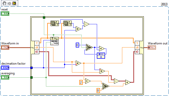

I have built up a VI to perform decimation (with optional averaging) on a waveform using 'Decimate (continuous).vi' from the Signal Operation Pallete and I have managed to get it to work such that it preserves correct values for dt and t0. The incomming waveform will possibly have a number of samples that is not an exact multiple of the decimation factor, hence the need for continuous decimation.
I would like to know if there is an elegant way to do this for a multi-channel waveform, where the number of channels is not known at compile time?

Hi Noah,
I think the issue with putting this code inside a loop (of any kind) is that the 'Decimate (continuous).vi' stores it's state internally and buffers some samples if the number of incomming samples is not an exact multiple of the decimation factor, it then uses these samples the next time it is called. This would result in samples being mixed between the different channels of my waveform array.

Hi Noah,
My reason for using the continuous VI is that the incomming waveform will not necessarily have a length that is an exact multiple of the decimation factor. Therefore I want the decimation (and averaging) function to buffer the leftover samples from each call to use when more samples arrive (my understanding from testing with a single waveform is that this is what the continuous VI does).
I found the following KB document that sort-of describes what I am trying to do and a potential solution (http://digital.ni.com/public.nsf/allkb/0388185F78143B82862578D9004CFA25), but to me the solution looks kludgy and it also relies on knowing the number of channels at compile time.
I decided to have a go at re-implementing the buffering functionality of the continuous decimation VI for a multi-channel waveform using the single-shot decimation VI. I'm not sure how efficient it is performance wise but it appears to do the trick:
This does rely on all waveforms in the array having the same length, t0 and dt, but as my waveform array is coming from a DAQmx acquisition task this is not a problem.
