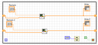

I create a subVI, like in the picture below. Where the "Numeric" control replace 1st value in the "Array" control, and move the result to "Array 2" indicator.
Then I create a VI, attach the subVI above:
What I want is, every 2 seconds, the array's 1st value is replaced by a number that I enter (numeric).
The problem is, while running this VI, only the second block works.
Is there any way that I can make 2 blocks work at the same time?
The .vi files are attached below.

Your VI is not reentrant, meaning that the "first call?" only executes once globally. Whatever instance executes first gets it. The other doesn't.
Possible solutions:
  1. Make the subVI reentrant.
  2. Leave it at non-reentrant but create a control for the init boolean and wire a i=0 to each instance.
  3. Initialize the shift regsiters on the main diagram with your default 5 element array and remove the first call primitive in the subVI.
  4. ...
In general, you might also want to initialize your shift registers. In fact you could make the subVI reentrant and have a feedback node inside the subVI, dramatically cleaning up your main diagram.
Here's how that could look like:
(2,056 Views)

That works. Thank you so much!!
