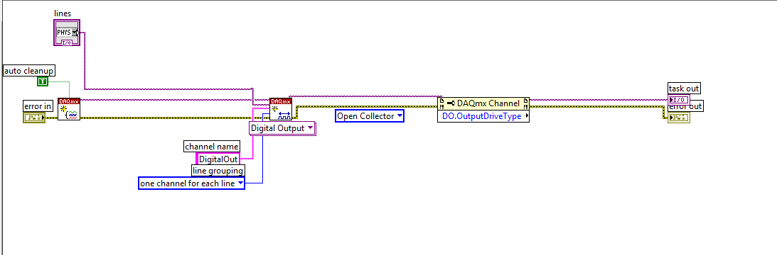

I want to use my USB 6002 as Open Collector ouput.
So I decided to follow this tutoriel : http://digital.ni.com/public.nsf/allkb/10056451DBB55A3A86256C61007117B1
However, I can't set an input to the channel property node, but only output (see the following picture)
Have you any idea of how I can configure the property node input?
Thank you in advance !
(3,359 Views)
Right-click on the propertynode and select Change to Write.
