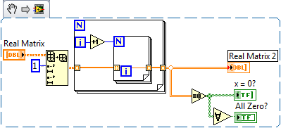

I have the following problem :
I have a matrix, in wich "i"  is the index of the rows and "j" is the index of the columns.
 I want to see if the elements  of the matrix that are situated below the main diagonal are equal to zero.
How can i achieve this ?  Any ideas ?

Thank you 4 your quick answer !
Because i'm using labview 8.5, i don't have the "Get Matrix Diagonal" function, so i would very much appreciate an vi containing this function as an example.
A example problem would be :
Given a matrix of the form :
1  2  3
4  5  6
7  8  9
i would like to find out if the elements situated at the indexes (i,j) : 1,0 ; 2,0 and 2,1 are equal to zero.
Thank you very much.

I actually assumed you wanted the first sub-diagonal instead of the lower triangular matrix.   Now you are stuck with indexing.
Here is 8.2 version as well.  After the For Loop the Upper Triangular part plus the diagonal will be zero automatically, if all of the elements are zero then you know the lower triangular part was zero.

Ok ! Thank you very much !
That was exactly what i was looking for.
